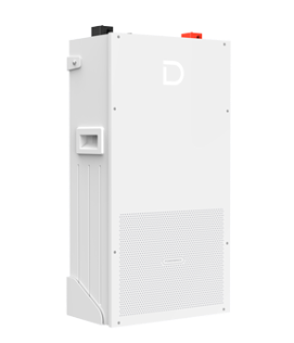

    https://www.nkon.nl/en/thuisbatterij/merken/nkon-ess-pro/nkon-ess-pro-51-2v-16-1kwh-thuisbatterij.html?gad_campaignid=21554569594&gad_source=1&gbraid=0AAAAAD1QO9ieyuoGgRsl9R-gSat3tuaxa&gclid=CjwKCAiAoNbIBhB5EiwAZFbYGCncubCLBdBe3eLSnosvAX22FFFODBd2CMLdLofZg9nxGeE8j8IGBhoCFygQAvD_BwE
    https://www.shop-rebor.com/en/products/dyness-powerbrick-14-3kwh?country=AT&gad_campaignid=22836456408&gad_source=1&gbraid=0AAAAADLQwnQ7VB4vI6SP6e7V6P84xnye9&gclid=CjwKCAiAoNbIBhB5EiwAZFbYGLzFZezHDVF6k3lAmMSDCDjaodjYTCkXT6aECFjEe9dGuz1963JJZxoC61kQAvD_BwE&utm_campaign=sag_organic&utm_content=sag_organic&utm_medium=product_sync&utm_source=google&variant=52443252490567
    Le texte ci-dessus a été traduit automatiquement.
